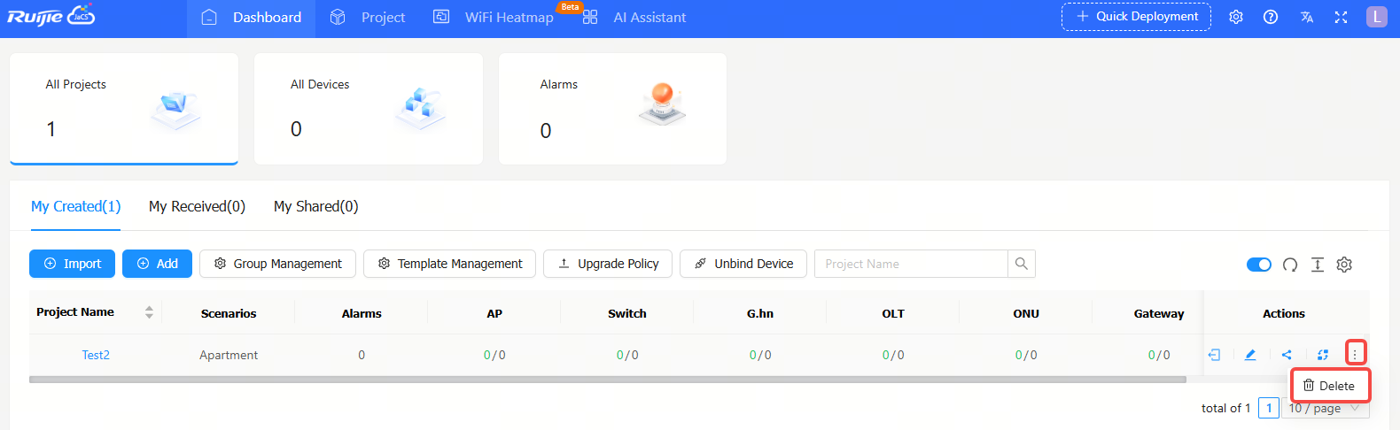

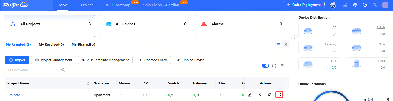

Step 1: Navigate to the Dashboard > All Project > My Created configuration interface, put the cursor in the  in the Action, and then click Delete.

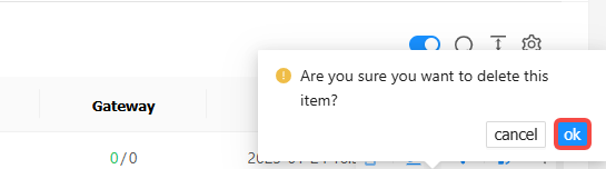

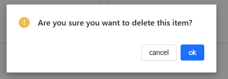

Step 2:  When the message “Are you sure you want to delete this item?” appears, click OK.

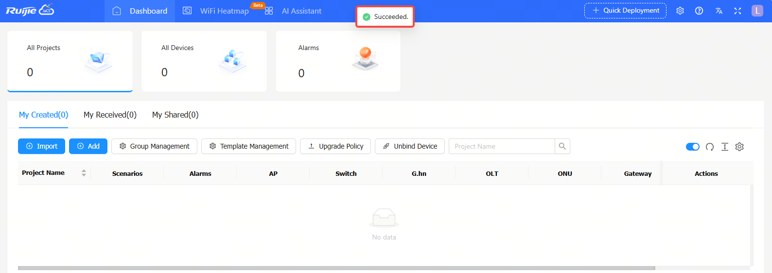

Step 3:When the “Succeeded”prompt appears, the deletion is completed.
