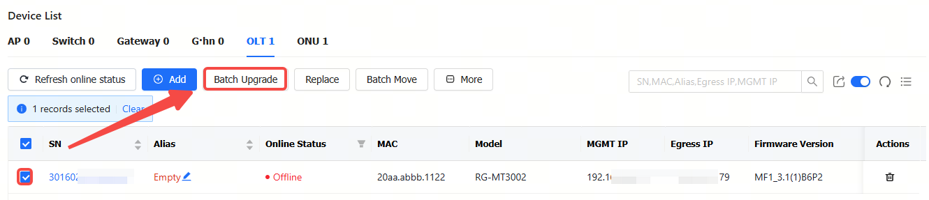

Step 1: Select the device to be upgraded, and then click Upgrade.

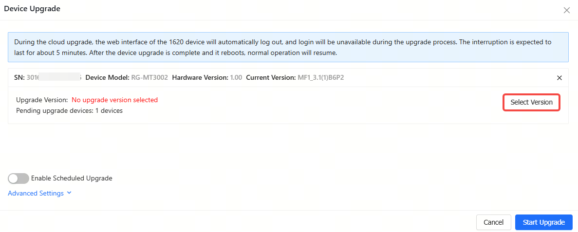

Step 2: Click Select Firmware to select a firmware version.
Step 3: After selecting the firmware version, click OK.

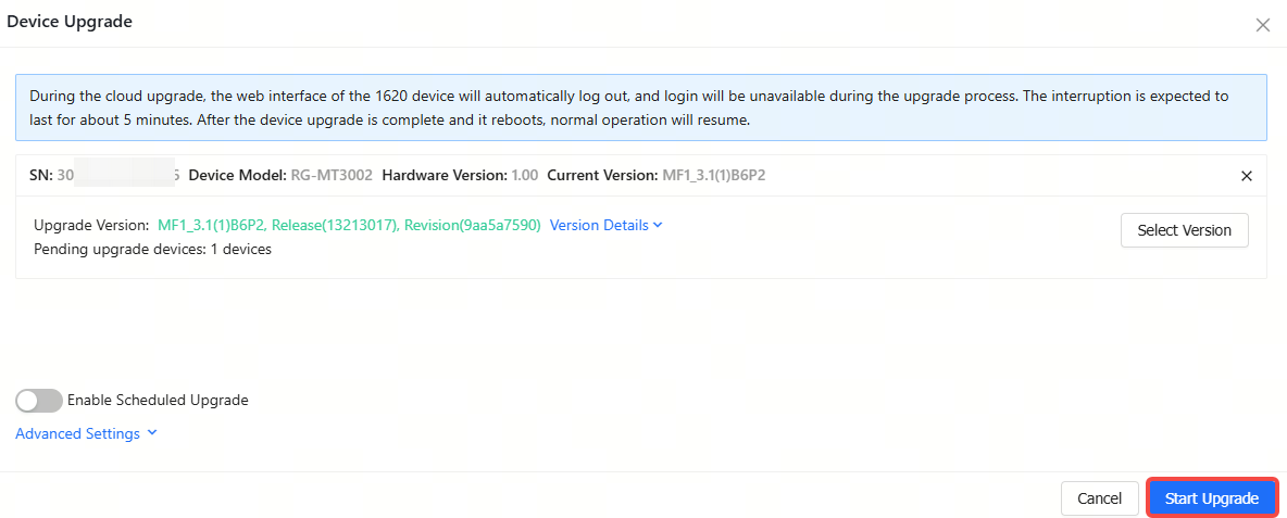

Step 4: Click Start Upgrade to create an upgrade task.

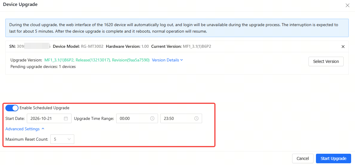

If you need to upgrade the device at a specific time, you need to check Scheduled Upgrade, and then set the upgrade time. After that, click Start Upgrade. The default number of upgrade attempts is 5.
